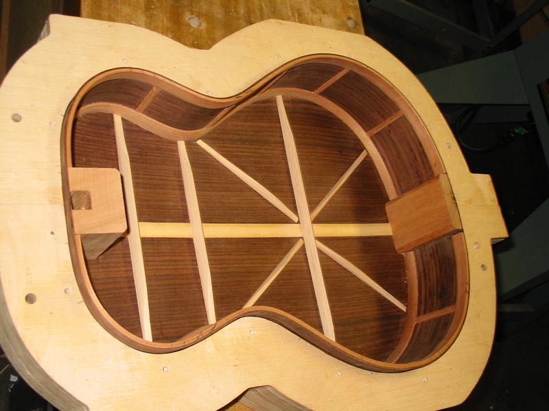

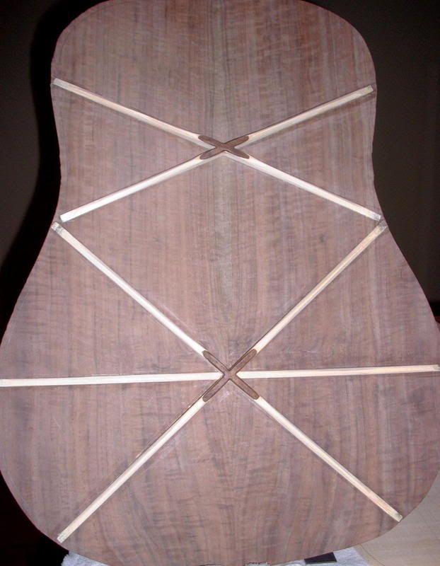

How about this...it is of my 2nd guitar. It is way over braced, but this gives you an idea. Good luck!

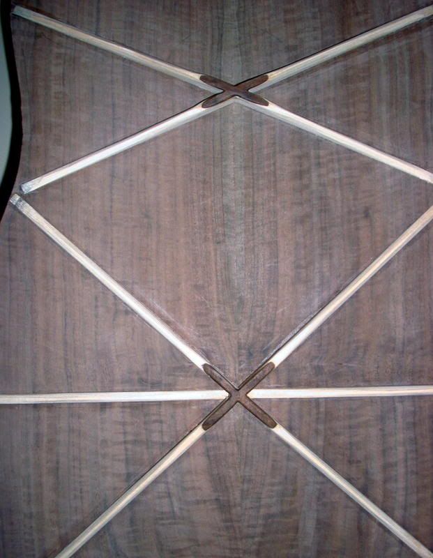

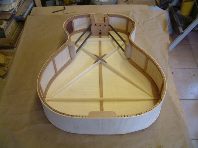

Crazytooguy I hope this helps. This my SJ design other wise know as the OLF SJ. This bracing pattern is on the OLF SJ Plans available from The OLF Library of Plans. The Snake wood cap was specific for this client
You will notice it is six sided star rather than just an X. this is to help support the extreme edges of the back at the apex of the lower bouts dome from wanting to flatten out.

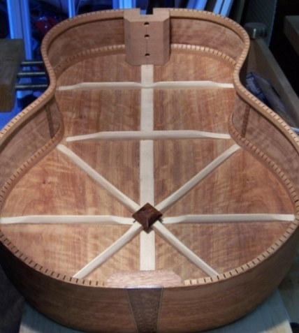

Here is my current build.
Similiar to Michaels but maybe a bit lighter. The cap is one piece maple shaped to an 'x' in place.

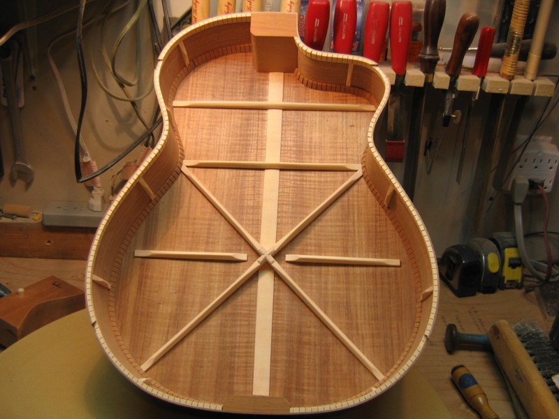

This is on my current build, I really like the result.
Greg

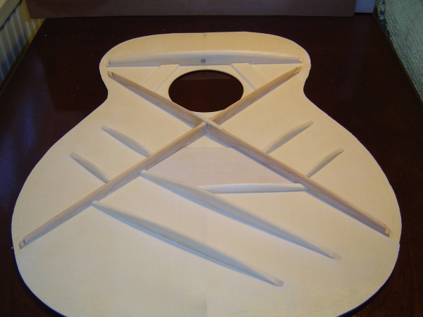

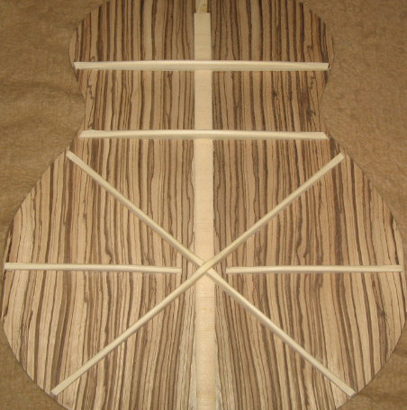

Here's more grist for the mill. Still needs final sanding, but very close to the final dimensions. X-braces are 3/4" tall at the center.

Yesterday, I posted a discussion on the "What about the sides?" thread outlining my theory of how the back functions and how it is affected by the braces. I was talking about standard ladder bracing, but the theory applies to X braced backs, too.
The first X braced back I saw was close to 15 years ago on a box built by Harvey Leach. It had just one big X, nothing else, and had, mainly, a loud bottom E string. I attributed this to the fact that there was little restricting the perimeter of the lower bout from vibrating.
These photos all show beautifully crafted braces, and Bruce gets the parabolic prize. But, IMO, they are all too heavy to allow the back to really work as I described in my previous post.
I built two with X braced backs, and was concerned about the unsupported parts, especially the diamond area between the X in the lower bout, and the one in the upper. I used a small lateral brace in between them .
Overall, I was able to get the same reinforcement as with standard ladder bracing, but the braces ended up much smaller than those shown here by the time I worked them down enough.
They are different, beautiful, and bound to attract the eye of a buyer or another luthier, but I concluded they were not worth the trouble, and didn't give as much overall support as standard back bracing.

[QUOTE=Scott van Linge] These photos all show beautifully crafted braces, and Bruce gets the parabolic prize. But, IMO, they are all too heavy to allow the back to really work as I described in my previous post.
Scott[/QUOTE]
Thanks, Scott, parabolic was exactly what I was shooting for. This is only my 4th guitar so I don't know what I'm doing yet.   I have read many of the theories and I'm absolutly certain that stiff backs are necessary for world-class instruments. However, I have also read that the path to incredible sound comes from flexible backs as you describe. I've even read that some builders start with one type and then convert to the other during their careers; all the while building the best instruments ever that capture the essence of that untimate vintage sound combined with purity of tone necessary for today's modern styles.
Please note that this is not directed at you. In fact, I've braced my top with parabolic bracing after reading some of your (and Colin's) posts touting parabolic bracing. It just reflects my confusion on the issue.

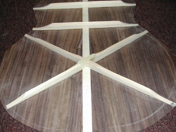

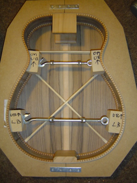

Scott, don't worry I'm an advocate of something approaching your system! As many here will tell you and noted by Bruce above I have been a great fan of "parabolic" bracing for many years. It is probably more popular on this side of the pond than on your's, as it suits the Celtic styles of playing and the more attacking modern styles of play popular here. I've built a lot of guitars that way and tune the top plate in a similar (though not same) way as you do. I don't say I fully agree with you on everything (we'll debate that another day!) but I think your work is both thought provoking and interesting.
By the way this is the top plate for that Walnut OM above, it will be my new dedicated DADGad guitar. As you can see we have ended up in the same ballpark, coming from different directions.
